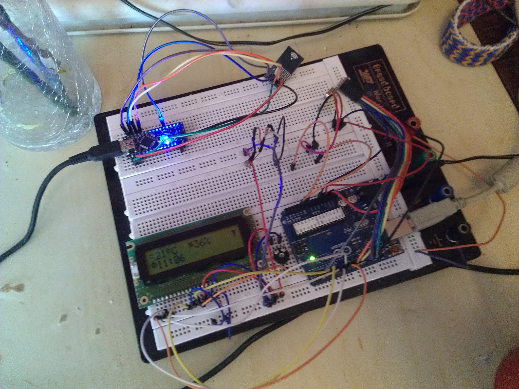

    Have a simple setup with a standard hitachi 16x2 display showing temperature, light level and current server time and connection status. Not done yet because i want it to show current scene for the location where this setup is add. But scenes are not supported yet.
    The setup is using the 1.4 beta library setup.
    Simple sensors display
    The temperature and the light values are updated every ten seconds (approximately) and values are send to the server about every 59 seconds. Also every minute the time is updated by using the time request method and displays the time in current timezone and correct offset (daylight savings). It can be +59 or -59 seconds off because the server does not yet pushes the time on change and is set on request
    On the display at the right top is a an antenna character which will blink of no data is received from the server. This is used in combination with the time request if there is no response within 3 seconds (quite a very large margin) the antenna will blink saying there is no server response. When the server responses again it will stop blinking. I on purpose set it on server responses and not at radio level, because both mean no server "connection" (interaction).

    Sure:
    This is the current sketch, it is not final yet, so improvements are not put in it yet and not all the doc comments.

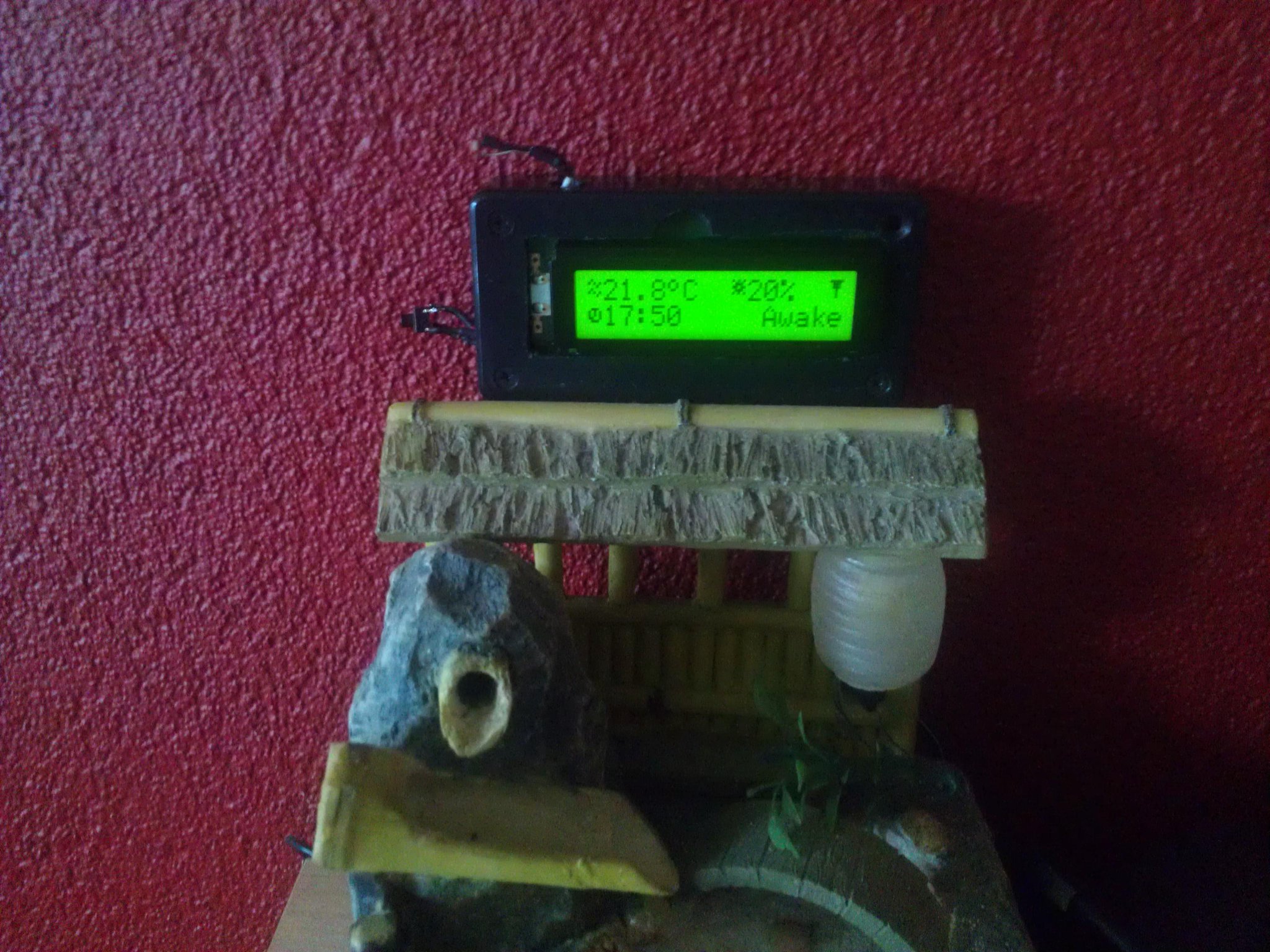

    Having a NPN laying around the display's back-light is now handled by the Atmega. And the display now shows overall users status (Awake/Sleeping/Away).
    The display turns on when the users status change, when a button is pressed or connection is "lost" (No server response). After 20 seconds of user change/button press/"connection" back the display's back-light goes off again.
    Planning: An extra button to send a signal to the server where it toggles user status to sleep/awake (all lights off etc.../morning routines) depending on time settings on the server.

    The below setup will run for a while until i have founded some suited casing for it... It has the same functionalities as above but in the end will get more buttons via a binary encoder i have laying around. So, it now is soldered and put in a case used in an other project (explains the BIG cutout where the LCD is seen. At the top the LDR, an the left a tactile used for the display backlight, and at the bottom (not seen) is a tmp36 sticking out.

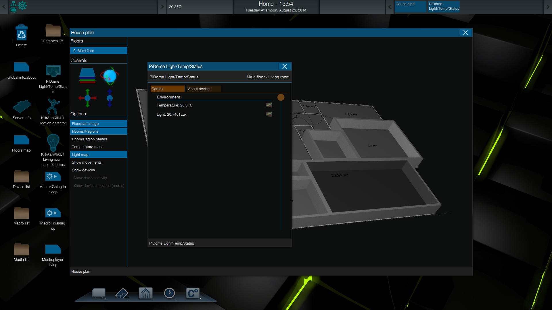

    I'm also busy with mysensors integration in the server i'm creating... below is a work in progress screenshot of a mysensors device to be added. All though it is shown in the screenshot, automatic node addressing is not yet supported. Also automatic device creation is not done yet, you will need first to define the device yourself (fields etc..).
    Add new mysensors device
    I'm also working on a desktop and mobile client.. This is how it looks in the desktop client when this specific device is added to the server and assigned to the floor planner with light intensity (LUX) enabled. Currently i only have one device active with lux (which is the device on this page).
    MySensors device in client
    I hope to get full mysensors implementation soon done, i will also include mysensor example devices to the mysensor device declarations.

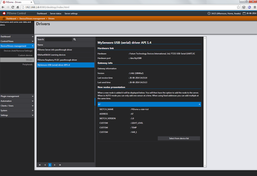

    Maybe it is handy to put an extra screenshot on how it looks when you add the serial gateway for the first time (page auto refreshes when an usb device is plugged in):

    I have updated the support this evening and the implementation now also shows the last 20 messages being requested to be logged by the gateway.
    Alt text
    Also i have added the possibility to auto assign node ID's but can not test it because the project i started this post with is running live with a server instance and is used in triggers which control my lighting... Current method is to turn on a sensor node, take a look at the last 20 messages (refresh the page by clicking on the MySensors driver). If the log shows an address is assigned, restart the sensor node.
