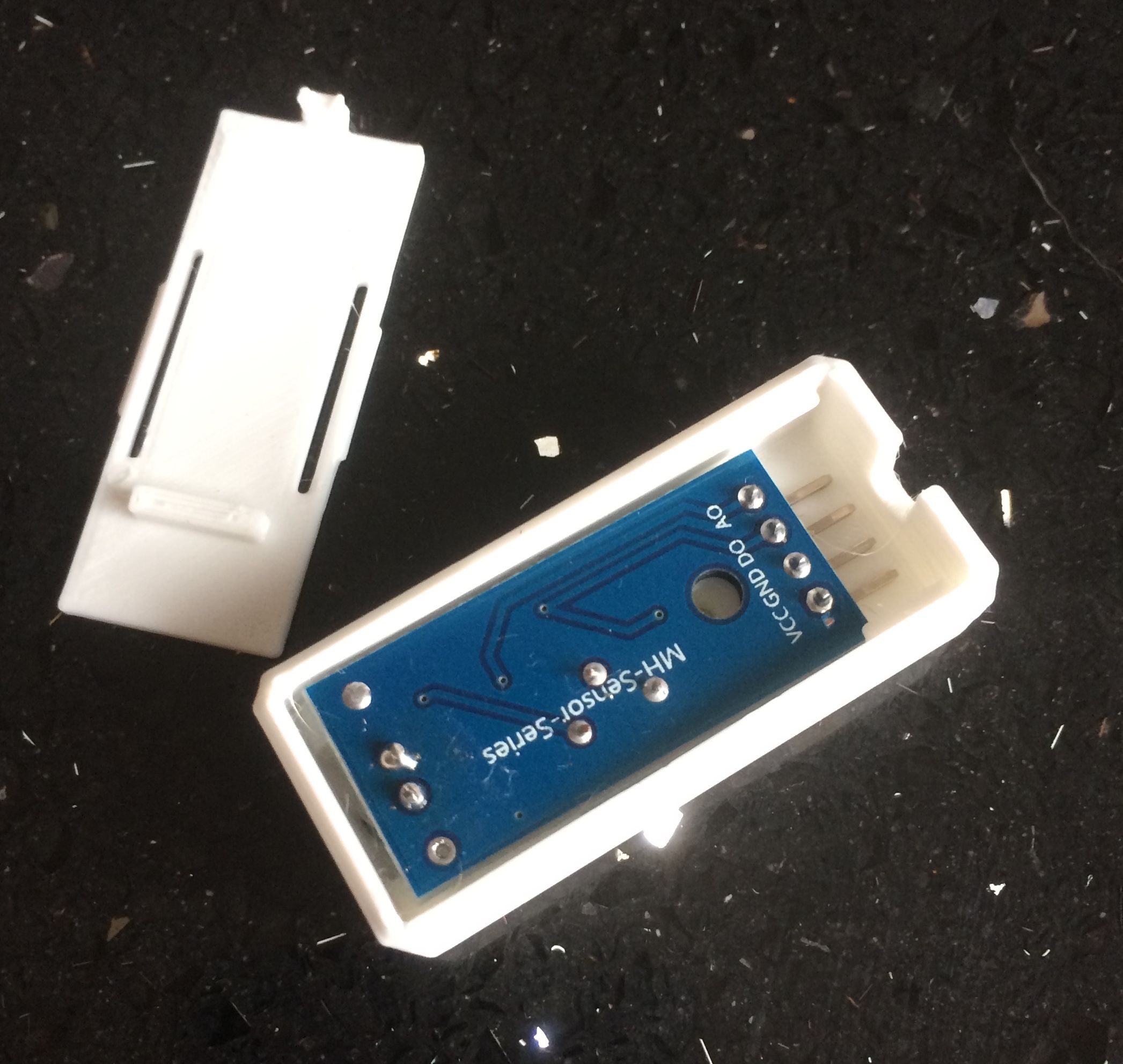

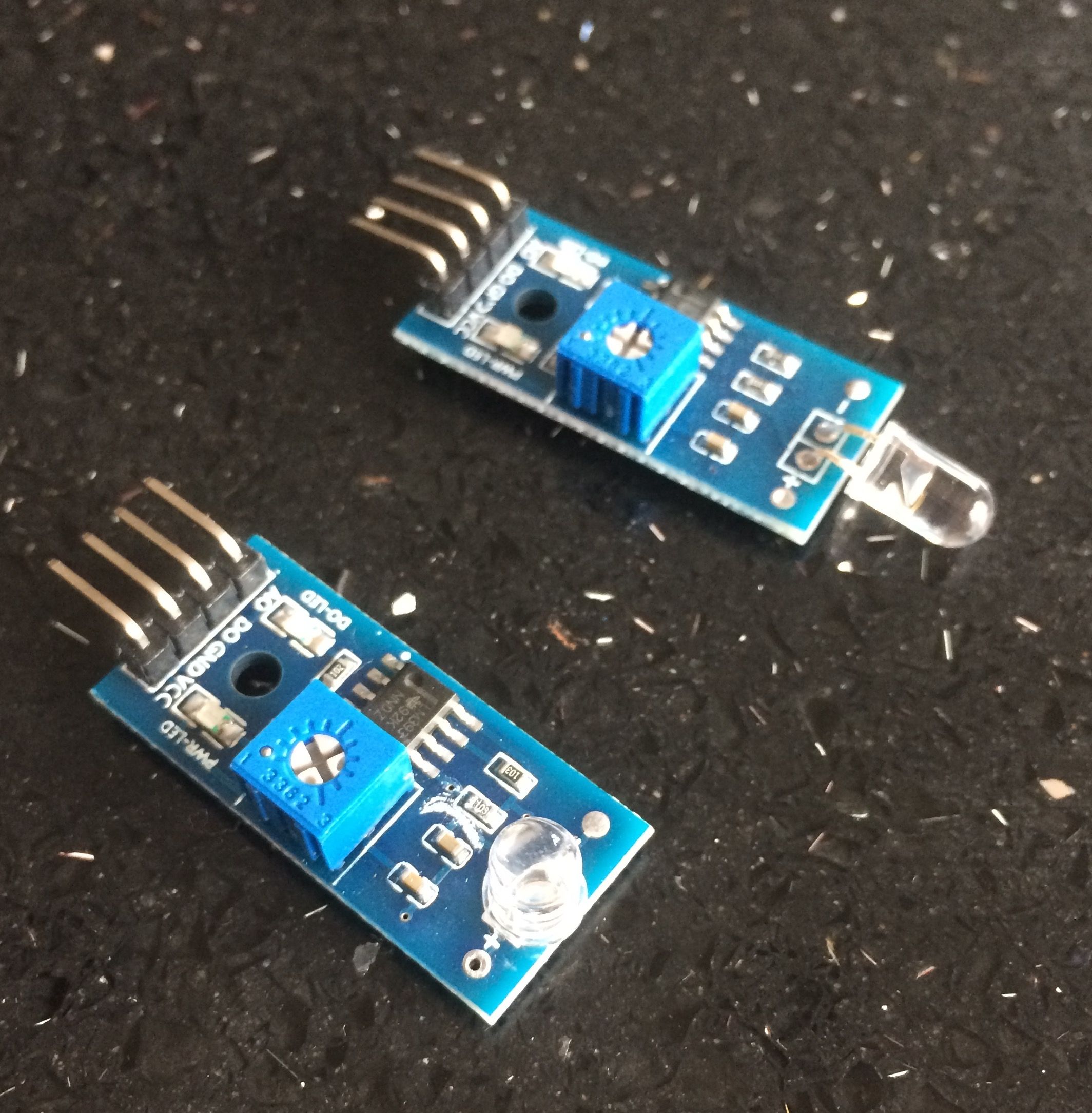

  • How is the pulse counter set up? Is it connected to the S0 port?
    Edit:
    If you are using S0 it is vital that you use a pull down resistor, if you dont’t have that you get false pulses.
    pulse connection
  • Mod
    I'm using the lm393 light detector. Domoticz is able to do a calculation from the pulses to give a Watt value and it is correct but it does it every 5 minutes and it is too slow for me

    Could it be the Light sensor is triggering more interrupts from each pulse?

    The main issue is the fact that the sensor is not calculating the instant power correctly
  • I created this kWh sensor with the TCRT5000 IR Barrier Line Track Sensor.
    My powermeter is a ferarrismeter with 375 rotations per kWh.
    I also had the problem with spikes in the power usage. But after long...too long investigation I solved the problem.
    At my config it was a double issue.
    Issue 1.
    The problem is the pulse width of the rotation.
    The pulse are at night ( low power) much wider that during the day when more power is consumed. At night the spikes in power usage where huge.
    Issue 2.
    Switching on/off the halogen light causes spikes and related to also strange power measurement.
    Solution:
    I added a second arduino mini pro as a pulse regulator between the TCRT5000 and the power meter arduino.
    this arduino triggers on Rising and will always give a 100ms puls. Als debounce is handled (spikes).
    I don't upload the sketch here, I'm a beginning programmer on arduino. It's made on " trail and error" but it functions as it supposed to do.
    If someone wants a copy feel free to contact mee

  • I've been building one of these pulse meters up, it seems to be working on the bench very nice. Just got to build a case and get a power supply of the Arduino. But I have designed a case to hold the LM393 sensor onto the meter. I removed the light sensor and re-soldered it flush to the board making it easier to mount on the meter. Its a simple box but works quite well.
    The files are on thingiverse here
    Hope this is useful.

  • @keithellis Lovely idea.
    I've followed suit and knocked up one but with the sensor facing the other way, so that it faces the meter, and the preset pot is and LEDs are facing away from the meter.
    That way the sensor side of the case can be stuck to the face of the meter, and the pot adjusted without removing it from the meter. The flashing light on DO flashes in sync with the LED on the meter. Theres a little ring that holds the sensor flush with the face of the case so it can lie flat on the front of the meter.
    Also, its a good idea to use black / dark coloured PLA so as to block out the any stray light that may illuminate the sensor (such as when the meter man comes to read it and shines a bright torch to see the dials).
