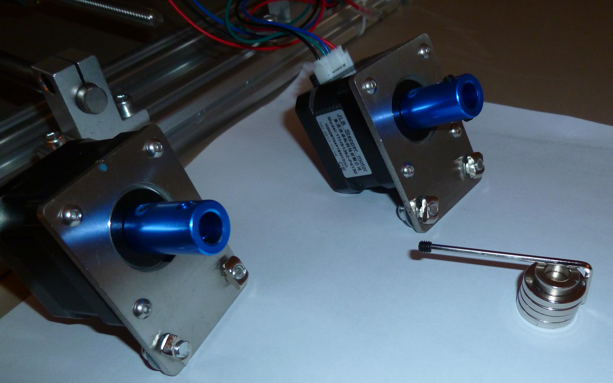

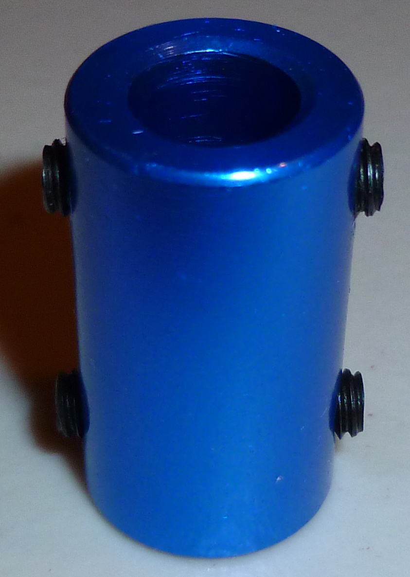

  • @andrew Just be careful with 6040, not to mention the 6090, they mostly use the same round rods as guides and at that sizes you tend to get a lot of "droop" (sagging), more than 1 mm across the long axis, which is ok if you're using them to carve wood or whatever but is very bad for pcb engraving.
    About the endstops, I don't have them and never felt the need for them, a cheap switch has a huge 0.1mm of error which can lead to holes milled between pads, cut traces, etc. What I do is place a hole in the sacrificial layer or the pcb near the edge, later if I need to reset the machine move the gantry manually so that the bit can enter the hole (spindle stopped of course), raise the bit and set zero.

  • Hero Member
    I don't see any plugs on the woodpecker board that are designated for connecting to a touch plate. So, I guess it's configured using the woodpecker header pins? How is that best set up?
    By the way, after re-tightening the set-screws on the adapters used to connect the step-motors to the screw rods, they seem to be holding now and not slipping loose. I take it back, one of them just came loose again. 😞
  • Hero Member
    @neverdie said in CNC PCB milling:
    And now the other one did too. Is anyone using a threadlocker on the set screws to keep this from happening?
    I think I'll put on some locktite and let it dry overnight and then see if it still happens tomorrow. I'll start with just the threaded rods.
    Anyhow, the good news is that the heat sinks plainly did not short out the GRBL controller boards. I guess the adhesive must act as an electrical insulator.
  • Hero Member
    Thinking about it now, an alternative might be to grind one side of the threaded rod flat in the region where it fits into the adapter. That would match the concept of the motor rotor, where that has already been done.
    Ideally I would notch it in just the region where the set screw makes contact. I suppose I could do that with a Dremel.
    Investigating now, I see that the adapter came loose on the motor rotor also. So, I think locktite will be a must.
    http://www.loctiteproducts.com/tds/T_LKR_BLUE_tds.pdf
    Looking at the datasheet, it takes 24 hours to cure.

    OK, here is what I'm doing in pictures. I'm applying blue 242 Loctite:
    to the threads of the 4 set screws on the coupler:
    That should keep them from loosening up after they are screwed into position. Note, you have at most 10 minutes of working time before it sets.
  • Hero Member
    I applied it to the motor set screws first and let it set:
    Note: I used rare earth magnets to help secure the set screw to the allen wrench. That insures that the set screw doesn't drop off and disappear somewhere on the floor. Works great.
    The couplers are made from anodized aluminum, so I'm not sure how well the loctite will work on them. However, I think it will still work, as the set screws themselves are steel.
