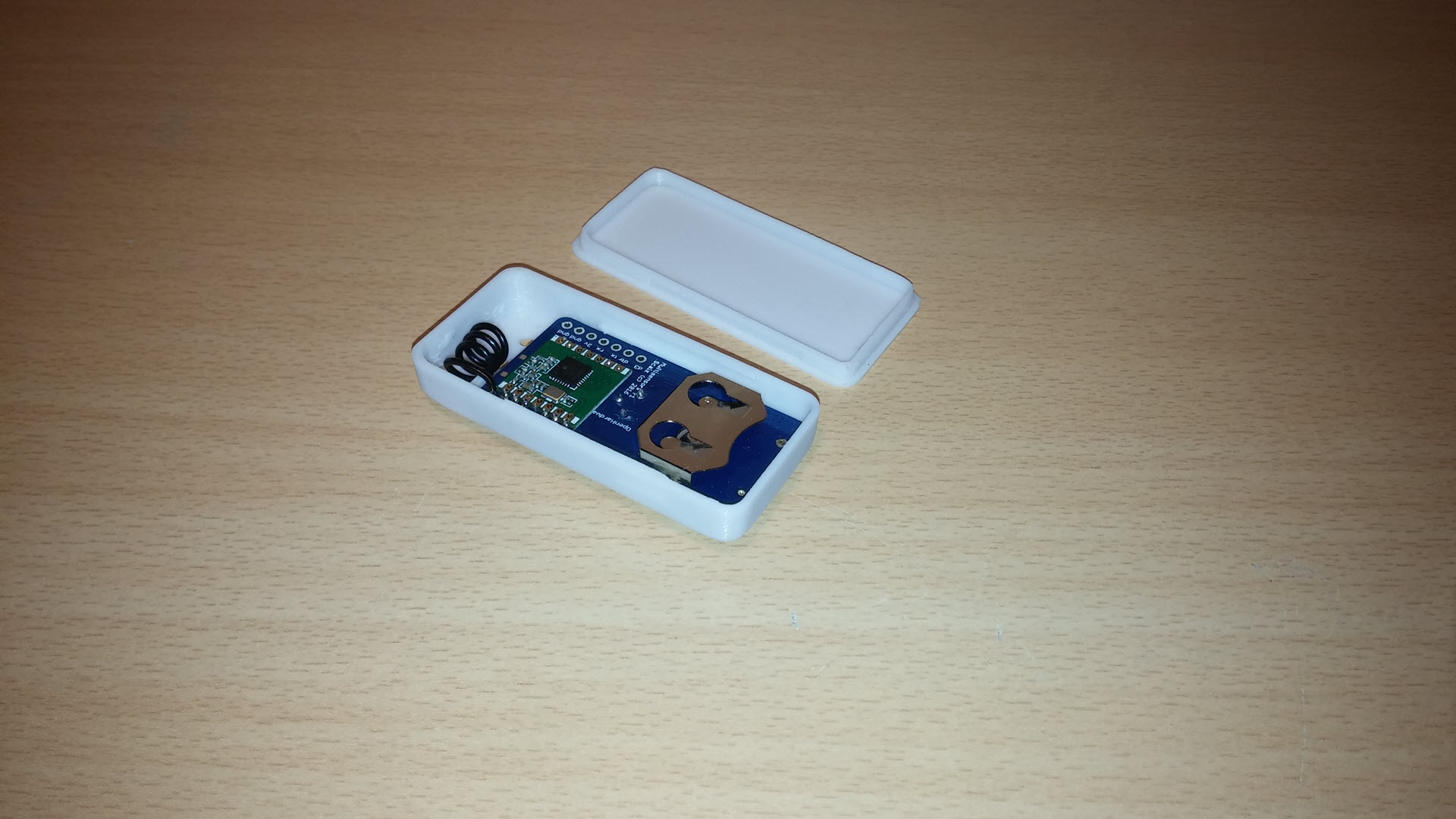

Few pics of another board i have just assembled. I have just noticed I didn't show any proof/pics
Top view
With this lense, I get 5-6m.
Bottom view, with rfm69, coincell holder and AVRSPI/FTDI connector.
I am waiting for rev 1.1 pcb. No big changes, I improved a bit silkscreen, removed the schmitt trigger to save some power and in place i use pinchange int, makes more sense. Few routes and size changed.
Though, 328p is memory limited, I have to disable debug for this one!
nothing fancy, just wanted to share how this is working as we're all busy..
there is a small problem with my widgets but no matter
I show you what this board outputs if you're curious, and I'm beginning to like this board
I will change my dashboard later, it's just for fun.

- Size is 25mmx49mm (same size as a nodemcu)
- Same specs as before, plus OTA. So optimized for very low power and coincell management. Temp/hum/pir/lux/contact door input
- Thickness depends on the battery used. That's great as now it's possible to use different kind of battery holder
CR2032 for the thinnest (8mm without PIR) very thin!, CR2450, or through hole 2xAAA holder
- you can see a test I want to try: a special antenna i saw on the forum. I will compare it with straight wire antenna, and coiled wire antenna.
See you soon
another little pic
left to right: 1) pcb without holder, 2) with cr2032 holder, 3) cr2450, 4) 2xaaa
different antenna format, i have not compared yet. But the straight one, if i remember well, reached 40-50m range with one brick wall (All are the low power version of rfm69, CW). As you can see the coiled antenna (4) does not take so much place compared to the 1.9€ special ant (3).
I can cover a nice range of use, yeah

3d printed box for a tailored stuff. I'll also upload .stl and design files. i'm looking at which parts can be "DP" on my BOM, for the pcba..

Hey!
Sorry for being so late, too much pending projects
but here is how looks the custom box for my project. I need to polish a few things, especially sort of mounting plate, then i'll release my stl.
Box is 62x29x 11.6mm
No nails no screws.
i don't like to search my screwdriver or needing screws, or a shorting circuit screw.. So when i can i prefer snaps!And in real
See you soon!
