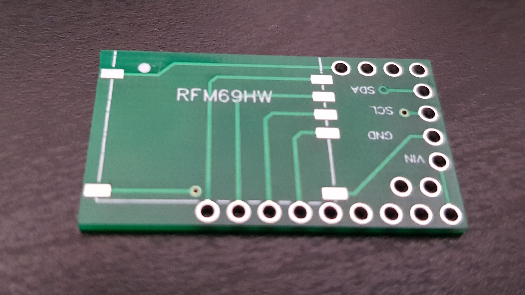

I just now posted Version 014. The changes are:
- I enlarged the pad holes by 0.3mm to make aligning the pins between the Pro Mini and the adapter board easier. The prior version worked, but the alignment was a little tight.
- I increaased the board size slightly in order to maintain clearances between the larger holes/pads and the edges of the board.
- I added some text to the bottom silk screen which better identifies the board and its version number.

I noticed that the RFM69 DI00 is routed to Pin 4 on the Pro Mini instead of Pin 2 that I usually use. Does this really work? How did you account for this in your sketch?

You are correct. It's a bug. I just now uploaded corrected files.
The current version is now Version 15.
So what is the easiest way to correct this if the previous PCB is used? Can I change in the sketch so it works anyway or do I need to solder some wire?
@Cliff-Karlsson
I suppose setting Pin 4 to INPUT after running a wire from Pin 4 to Pin 2 would patch it. Or you could solder bridge between 2 and 3, and then solder bridge again between 3 and 4. In that case, you'd set both Pin 3 and Pin 4 to input, assuming they weren't being used for something else.If you have the boards but haven't yet soldered the headers, then I suggest doing the solder bridges, but don't connect header pins to pins 3 and 4. Then there's no need to set pins 3 and 4 to INPUT. I think that would be the cleanest fix.
That said, if the firmware you're running isn't relying on interrupts, then no patch would be needed. For instance, I had previously tested the PCB using lowpowerlab's node and gateway example code, which doesn't use interrupts for send and receive. That's why I didn't notice the bug until it was pointed out by Korttoma.
Also, I shrunk the board a little bit in Version 15, so it should cost less to get fab'd. On OSH-PARK, for example, it would now cost exactly $4 for 3 boards.
For some reason the Version 015 files disappeared after I posted them. So, I re-posted them this morning. Hopefully they stick this time.

According to this connection guide https://www.mysensors.org/build/connect_radio the pro mini D2 will connect to RFN69's DI00.
But the shield seems to connect D4 to DI00.
Is it OK? Or we need to adapt our sketches?Thanks
@muguran said in
Arduino Pro Mini Shield for RFM69(H)W:
Actually, no. DIO0 does connect to D2 on this shield, so there should be no issues.
It seems that I've got another board: it have 4 holes above GND, D2, D3 and D4, and DI00 is connected to the one for D4.
Is this an old version?
I've ordered at the beginning of this year.
@muguran post a picture if you can
@muguran
Yes, that's an older version. A fix is discussed in the comments above.
