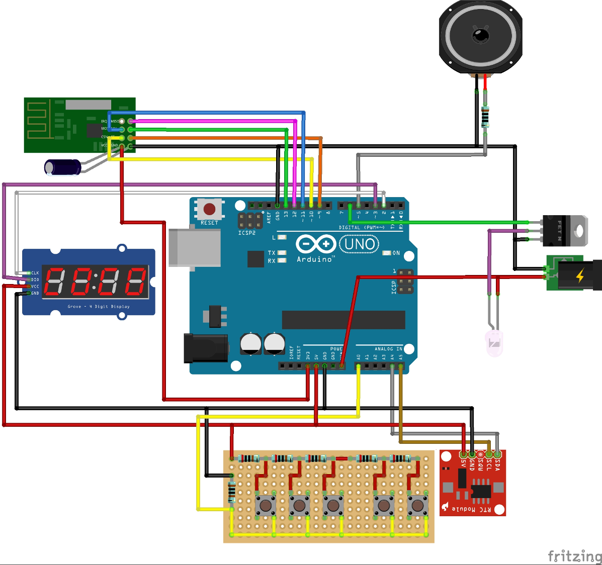

  • I am just curious why you did your switch board the way you did? You can do a similar style switch setup using all the same value resistors. Then you don't have to buy so many different resistor values. Something like this:
    0_1508986754912_upload-8f7eb5ee-6fac-4bb8-8ef7-c5a3c6f82e0c
    In this approach, whichever button you press, the resistor values, being in series, add up giving you a different voltage on your analog pin. With your approach, you use different resistor values on each switch which gives you your different voltage. My approach is only slightly different than yours. I am just wondering if there is an advantage one way or another.
  • Hardware Contributor
    @dbemowsk said in 💬 Smart Alarm Clock:
    I guess it is useful in the case when user pushes more than one button ?
  • @Nca78 said in 💬 Smart Alarm Clock:
    I hadn't thought about that, but you are right. In my example, you couldn't press more than one button.
  • @Nca78
    exactly correct.
    I originally went with the same resistor value so that it was easy. But then when I thought about how many button combinations I wanted (thinking about a real clock where you hold down the alarm set button then press the hour button) I went with different values.
    My implementation still isn't perfect, since I'm a bloody amateur... lol. I think 1 or 2 of the combinations I never got working.
    But for the most part it accomplished what I wanted... provided many buttons and combinations on a single input pin, since I was quickly running out of them
  • I found a library online.... #include <AnalogMatrixKeypad.h>
    I made some modifications (although I can't quite remember what they were), I think about the number of buttons, or combinations, or target values.
    But generally the library provided the 1 wire, resistor ladder and debouncing functionality I needed
  • I often wish our fancy mysensor nRF chips only used 1 arduino wire 😞
  • @micah Picking resistor values based on the number of switches you have shouldn't be too terribly difficult. You ar just creating a voltage divider circuit. When pushing multiple buttons, you just have to look at the resistor values for the buttons you have and calculate out the parallel resistance. Then you just have to figure out the analog value for any key combinations you want to use and create IF or Switch/Case statements to perform your logic.

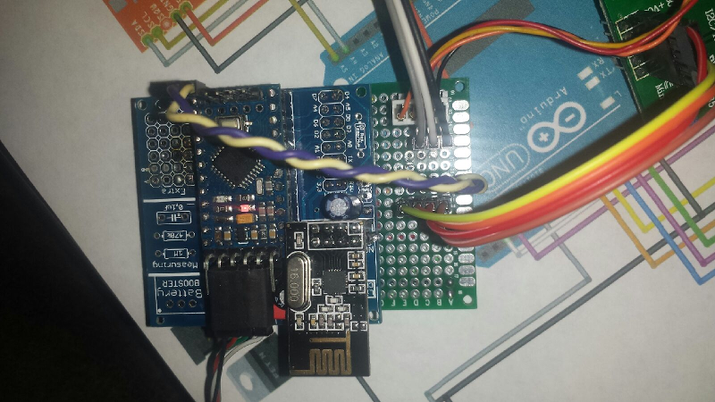

  • Here is my start on this. No speaker yet and I haven't added the LEDs for AM/PM and alarms, but that will come.
    0_1509333312144_upload-29d46ab7-e40a-49b9-aa1e-330beede8488
    I will need to make a bunch of modifications to the sketch. Mainly because I am using a different RTC module (DS1307). It is one that I have had laying around in my parts bin for years. I get a bunch of compile errors when I try to include the RTC library for this module.
    0_1509333483010_upload-75b8f66d-d692-412f-9171-d0175ea0402d
    Here is the board layout so far.
    0_1509333525901_upload-7777b1c8-2200-4300-aae8-c0a94786b7c8
