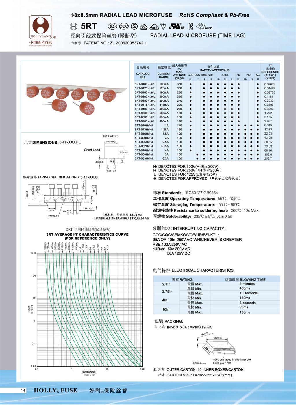

    Could I ask the reason for the slow blow fuse here, what is specifically drawing high current at startup? I ask because i'm attempting to make my own on board AC-DC solution and I'm very tempted to put a fast acting fuse on the other side (DC side) of the AC-DC converter. I'm not sure what would be drawing your initial current spike (if you have one). The only things i can see for you is the on board relays....
  • Hardware Contributor
    @Samuel235 Check http://forum.mysensors.org/topic/1607/safe-in-wall-ac-to-dc-transformers/295 - below post #295 is a great discussion about slow/fast blow.

    I took some 250mA fuses as no one was selling 200mA slow fuses on aliexpress, and also some 77°C temp fuses instead of the 73° because they were less than half the price. I'll grill one or two to make sure they are real temp fuses when I receive them 😉
    Not sure if I order the PCBs from DirtyPCB now or if I wait to received my previous (and first order there) to be sure they will reach my mailbox...

  • Dear All,
    I'm interested in build some exemplar of this beautiful project, so for that reason I ordered all the items present in Bill Of Material.
    I ordererd most of the item without problem, but I get in trouble in finding the "Slow Blow Fuse (250v 0.2A)", as in the link given, the 0.2A fuse is not available and in plus the seller doesn't send to Italy.
    For that reason I started a search in a lot of different shop, from the most knowed to the less knowed, but I'm not able to find it for a reasonable price.
    As example I found a Company that sell 10 of it for a total of 3.40$ but they ship it for 35$, so I think is a nonsense.
    Other Company only sell minimum quantity of 1000 item, but I don't need that amount and in plus the price will become very high.
    So for that reason I ask you if someone can suggest me an internet shop where I can find it for a reasonable price (item+shipping), or eventually if it's possible to substitute that "Slow Blow Fuse (250v 0.2A)" with different kind of fuse maybe more easy to find.
    Or as a last chance, if someone eventually have 10 of it and is available to send me (off course I will pay for the item and for the shipping) in Italy.
    Thank you in advance for your attention.
  • @Mercury69
    See: Aliexpress Sorry these required a fuse holder 😞
    maybe this one ? Mouser.it
    Sorry the shop I bought mine from doesn't sell a single fuse anymore ...
    I don't know if these fuses will fit on the board but they are the closest specced having some leads :
    https://www.aliexpress.com/item/10-pcs-lot-T250mA-250V-TE5-Slow-Blow-Subminiature-Fuse-UL-VDE-RoHS-Approved-250mA/32712347448.html
    I think it would be better for next revision of this board or future boards powered from main to use a fuse holder...
  • Thank you to all for your rapid answer.
    @Amster
    I saw the fuse in Mouser website, I think the same one is the following:
    http://www.mouser.it/ProductDetail/Littelfuse/0875200MXEP/?qs=%2Fha2pyFadugxaz6Ka1QIzhvtD8HnMnU0Sbd%2Fe9cxA257in2%2FbECi0w==
    I also called they and they told me that only after I will put the order they check the real availability in the various site they have and if present they send me, but if not present I have to wait 10 Week as this is the Factory Lead Time.
    And more of this the shipping will cost 20€, so a total of 39,80€ for 10 little fuse I think is too much.
